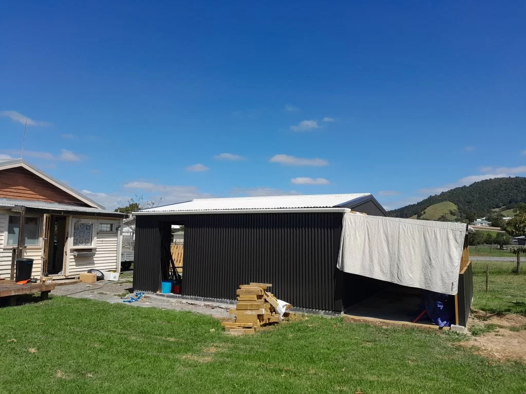

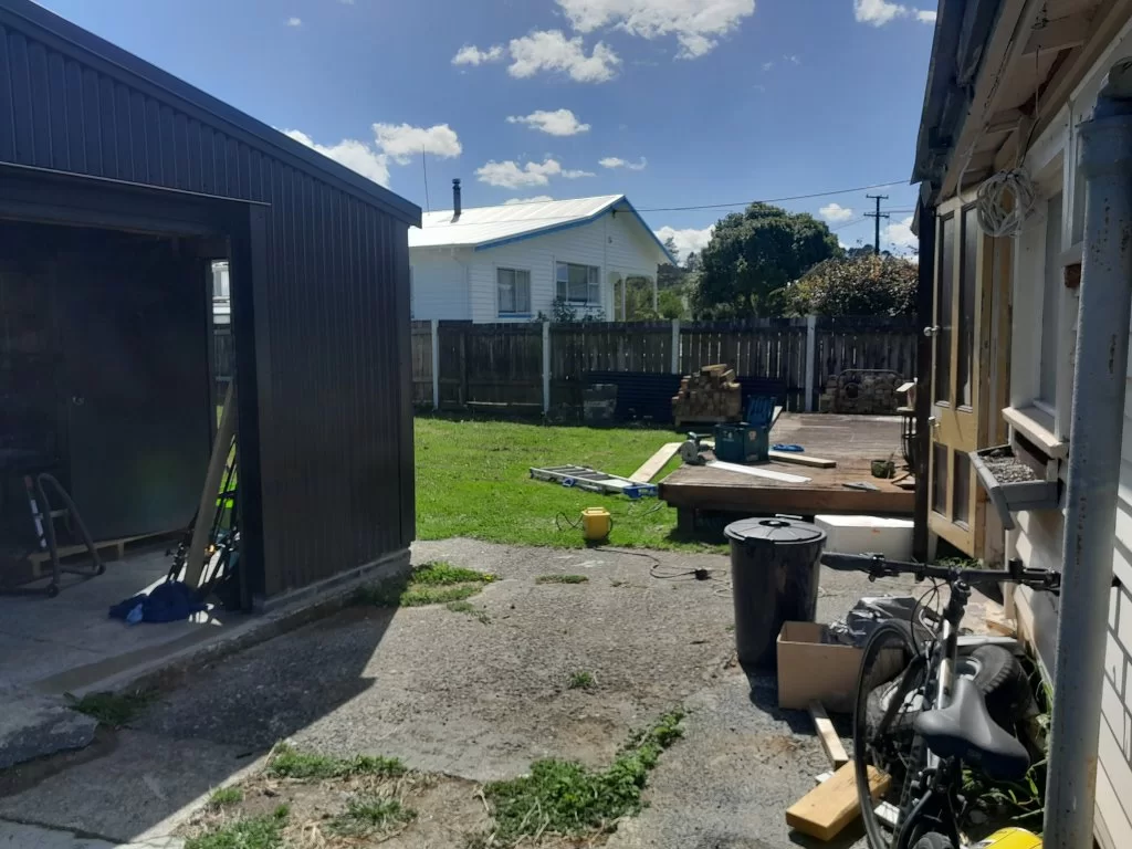

Up nice and early this morning.. bout 9.30 ish... went for coffee then got into painting the garage roof.. as mentioned earlier, it looked like shit but doesn't leaks it can stay for a while yet.
Why light grey? I hear you ask.. coz it was free!!! Probably look better matching the cladding but I don't mind it. B thinks it looks smart.
On close inspection it's pretty rough but it looks tidy and is sound..
Anyhu, 3 hours later and it's had 2 coats. Job jobbed...

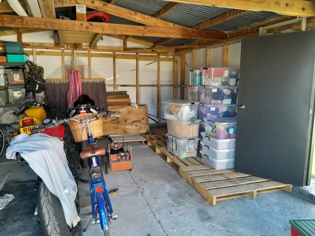

B stayed home and started moving stuff out to the garage.. I would have felt bad about her doing the graft while I had a beer at the pub, but given she stayed in bed whilst I painted the shed roof and didn't get up till nearly lunch time, I didn't.. feel bad that is..
Anyhu, she's done good. Another hour or 2 and she should be nearly done!

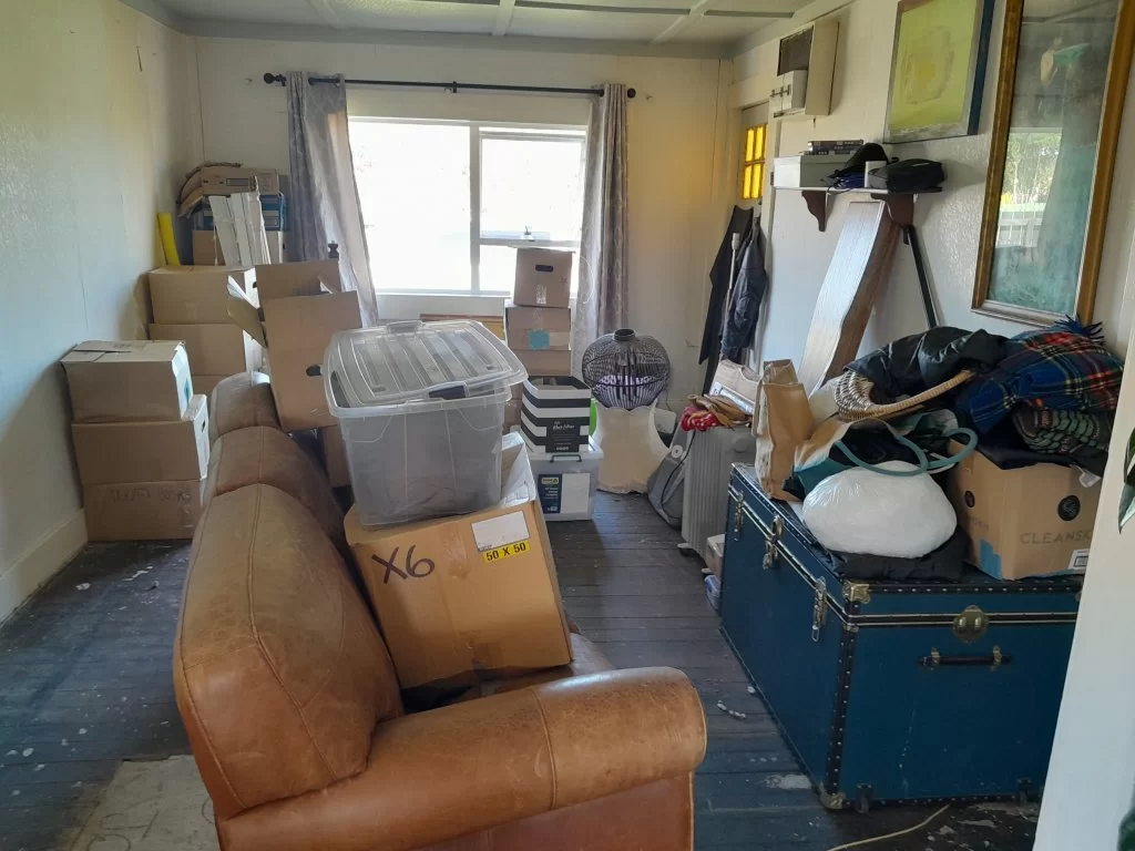

Well the emptying of the front room took b a Lil longer than expected but she got it done in the end!

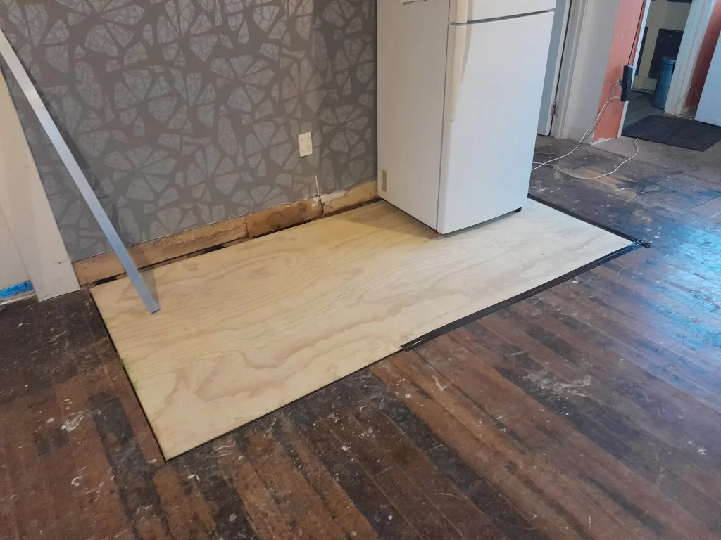

The ply I ordered and paid for week before last finally arrived and I picked that up Wednesday. That is now stored in the lean to so no hammock space !!!

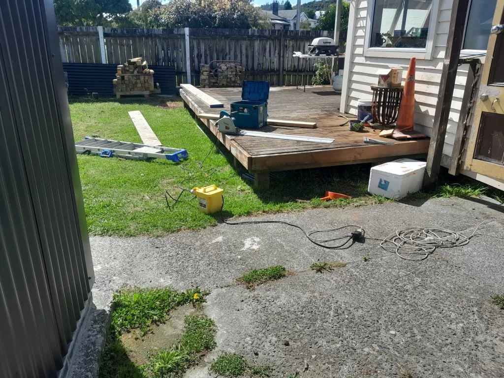

I'm all set to start pulling the floor up in the front room but wanted to do a Lil job out side this weekend.
That was cut the deck back on an angle so there is enough room to get the trailer out back. Even with it cut back it's way to tight to tow it round there but it can be pushed back there for storage.
Anyhu I started cutting the deck back, whilst having a look at some stuff I noticed the waste pipe to the kitchen sink has come apart meaning all the waste water has just been running under the house for God knows how long!!! Can't smell it from anywhere which surprises me coz when ya head is down there, it fucken stinks!!!!
To access said pipe I needed to remove more of the deck. Not a big deal as we had talked about doing just that any way. That section of deck doesn't get used so much and would probably be better at a lower level to create a step and be Same hieght as the back door step. Gunna cut it back to the corner of the house.
So I started on that.. didn't get real far as it was 1 o'clock by then and the pool comp started at my local at 2. I needn't have bothered with the pool comp, played like shit and lost both my games. I did draw 2 of the top players mind...
Anyhu, ya can get a car out back now and I'll finish up tomorrow...

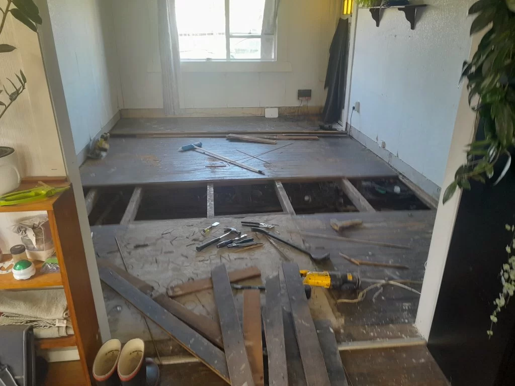

Today I finally started ripping up floors!
Done some more indepth surveying with the Laser and am now a Lil worried!!!!

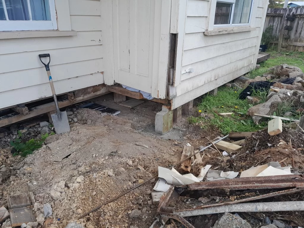

Over they last few weeks I've pulled up a few more boards, packed the house in a few places, laid the ply in the bedroom in temporary and planted one pile!
Not a great deal of progress.
Work and other activities have got in the way..
Did a full day yesterday, but that don't look like much either!!

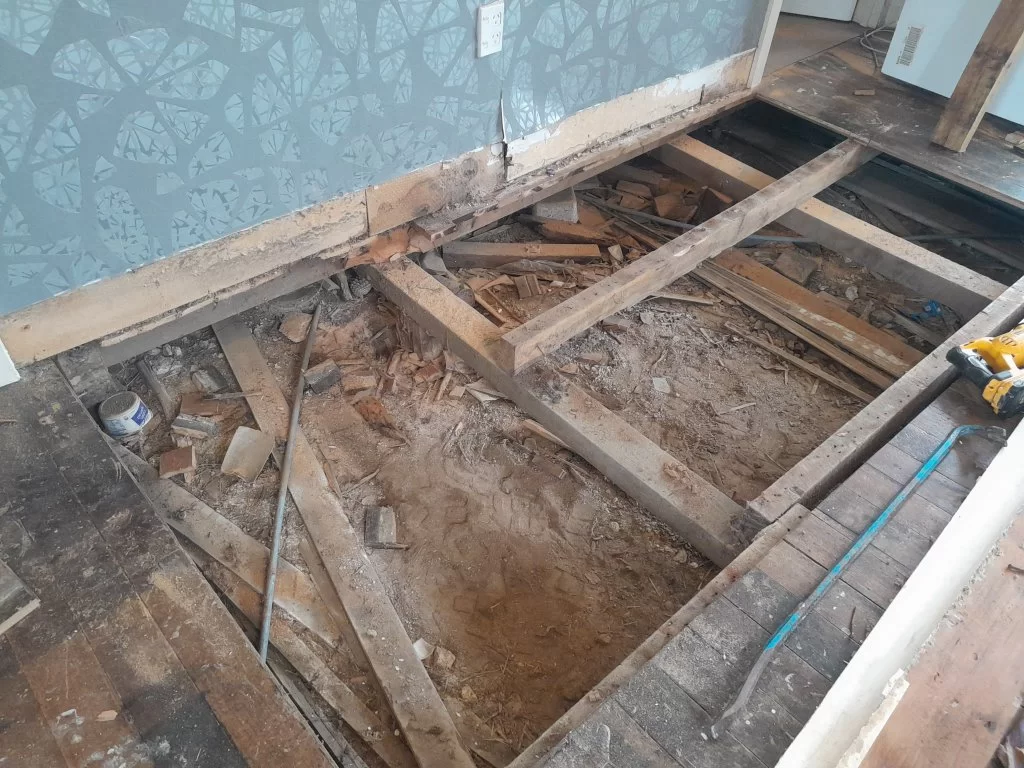

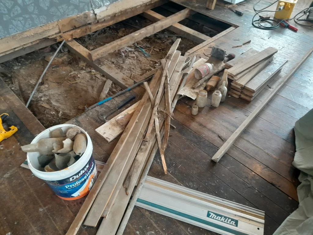

The dinning area floor seemed to be getting more uneven and wobbly so pulled up a section to have a look.
The pile beneath the spongeist bit of floor has sunk and there is a 50 mm gap tween that and the bearer.
Guess there was a load of weight in that area for some time ( probably fat Guinnesss sitting at the dinner table) the that weight got removed There is only 2 large nails through the bearers into each pile and most so far have rusted out, with the weight move and pile no longer fixed to bearer, I guess the bearer flattened out some creating this gap?...
Anyhu, ended up cutting an 8 x 4 section of flooring up, denailing joists, clearing, packing and laying ply in..
Hard to believe that's a days work but it was.
The amount of crap under there is amazing!!
Some from when it was built, some slid under there deliberately over the years( lengths of timber and pipe) Some wind blown and some I just don't fucken know how it would have got there!
So much broken glass..
So start by removing all the visible glass and putting aside, then paper, plastic, metal ect, then rake and sort some more , then load all the loose dirt in bucket and carry out, then scrape soil down till nice and clean and flat..
In the 8 x 4 area ( or 2.88m2) I probably took out 30 20ltr buckets of crap and soil along with shit loads of soil..
A few pics now as although there is loads more to say, all these words get boring..

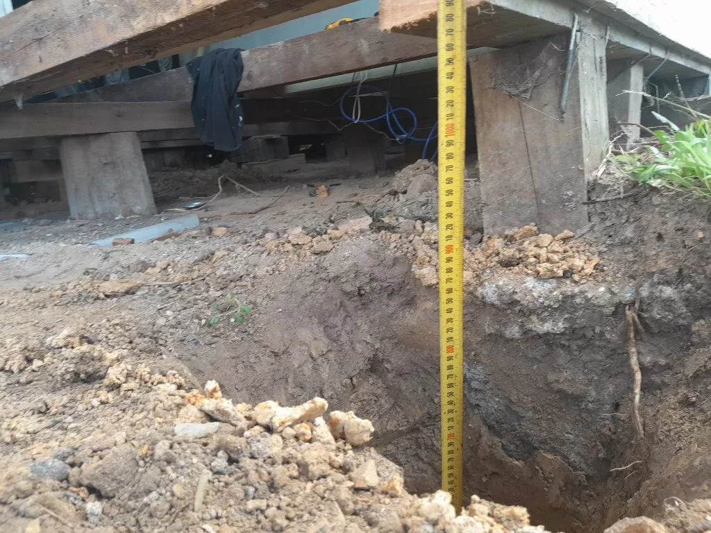

In the pic of the hole I dug for the pile, you can see I've gone 900 deep. This is anchor pile, the bulk will only go down 450.
Where that pile is I jacked that corner up 15 mm to match the highest point in the house.
Gunna fix that pile to bearer with ss plates ( that I picked up yesterday) before I lift the next section along as that needs raising 23mm and I could see the bearer lifting of that new pile rather than bending if not fixed.
In other pics you can see some of the crap I had to take out. Those were taken after alot was removed as I forgot to get snapping!
That bucket of glass is from that 8 x 4 area.

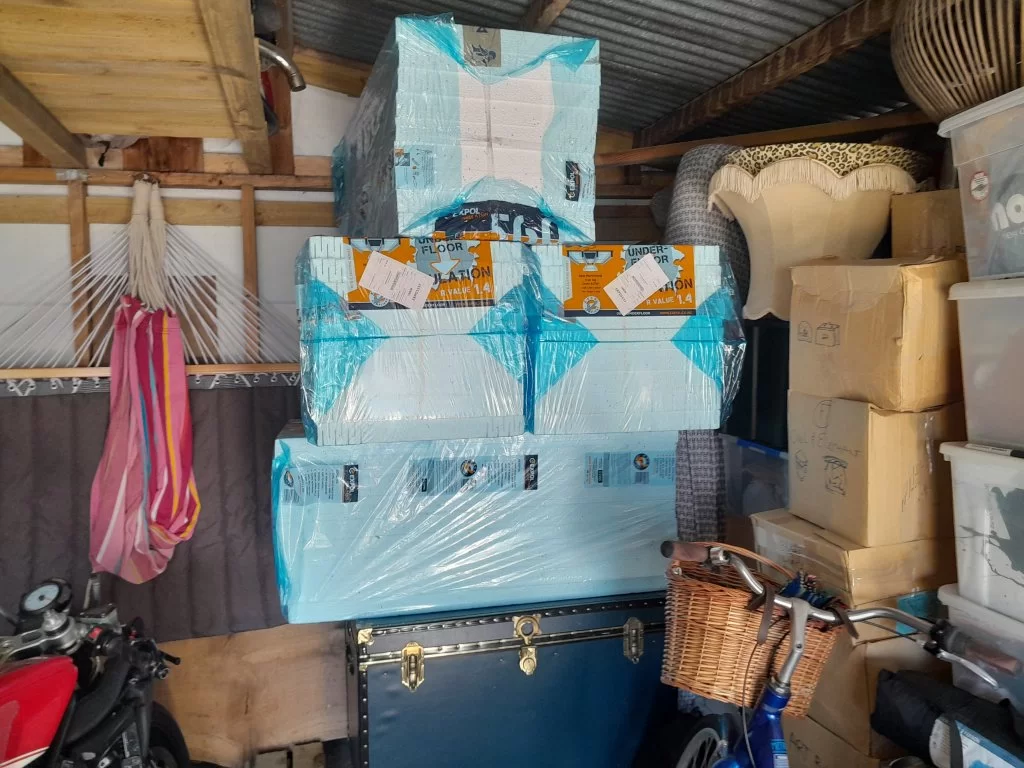

Insulation, bottles and jars, builders mix stores, new foundation piles, an ever growing burn pile, an ever growing crap pile and the hammock space taken over by materials...
