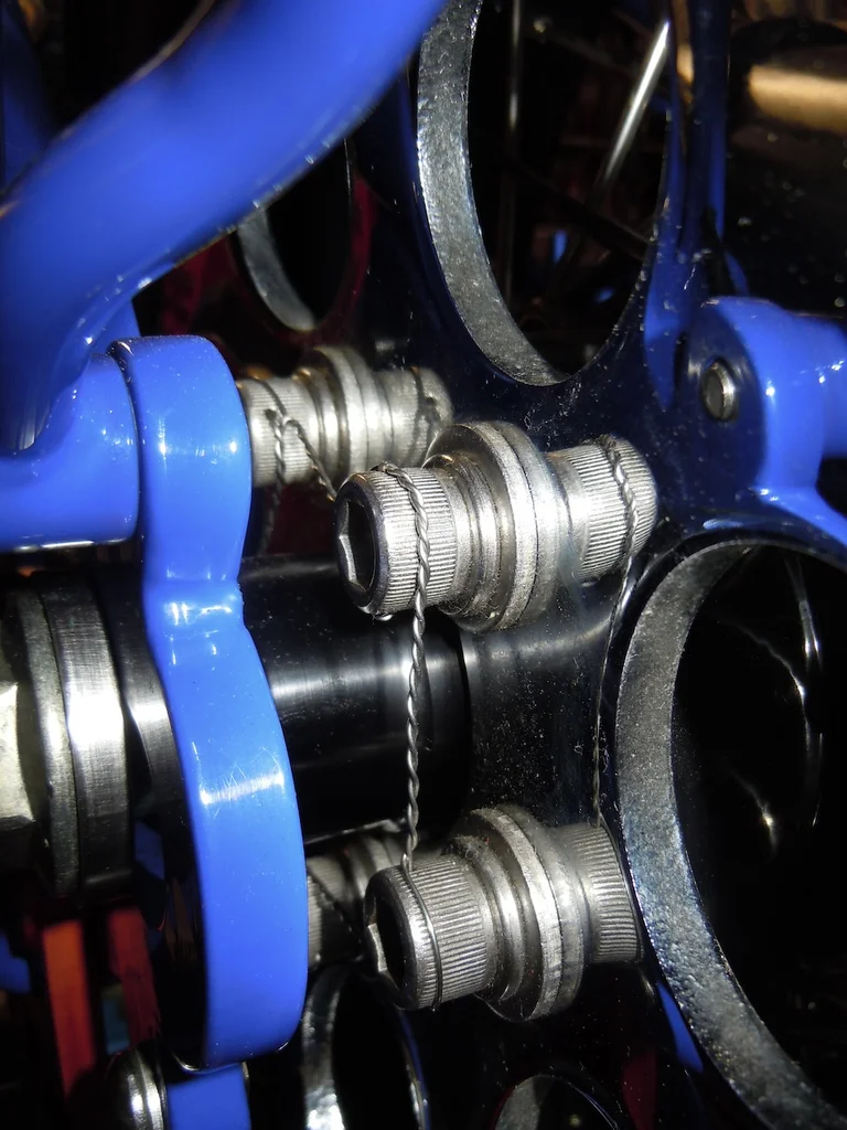

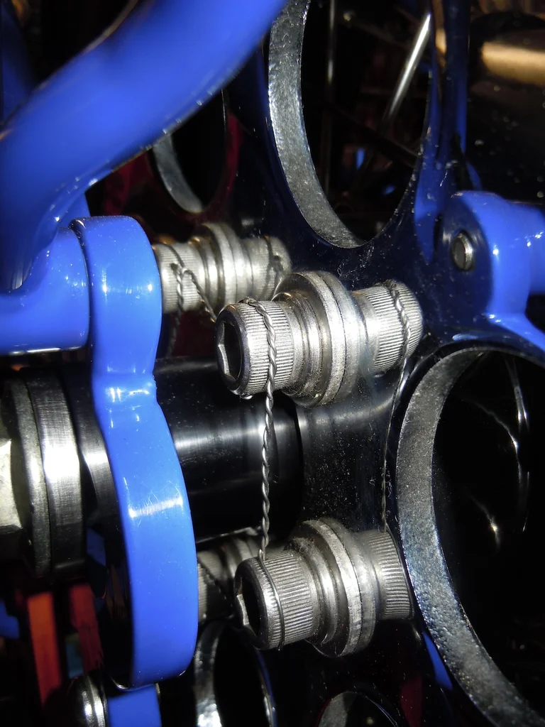

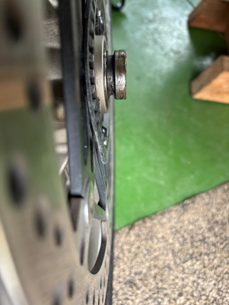

Call me cautious, but just to be safe, the rear sprockets on my bone-shakers have spring washers, Loctite & wire-locking !!

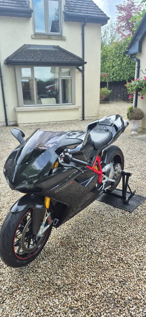

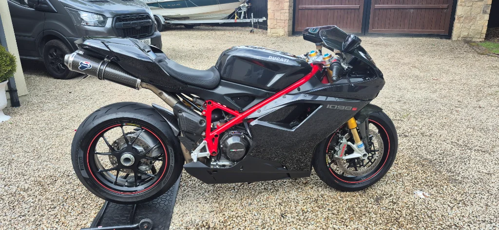

A pair of "slash-cut" cans would look good on that ! (y) .......... If you don't mind me sayin' ;)
Yea they look the dogs bollocks but back when these cans went on they weren't readily available so the termis got fitted the bike is 09 with on 4000kms on it so its very low miles .... I think this is one of the best sounding Ducs before the squarer engines took over from the longstroke motors 👍
