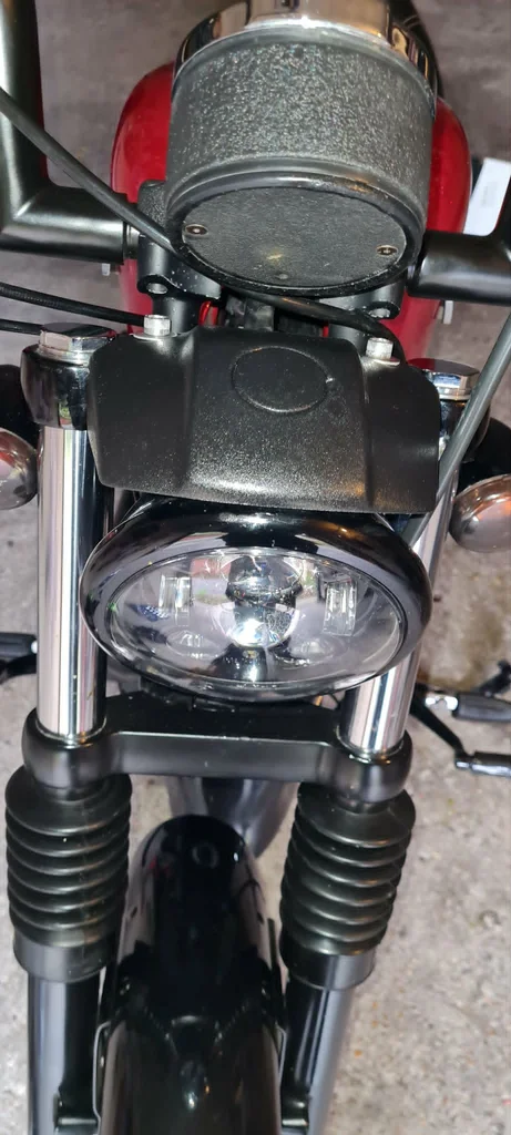

Today i was going to go for a ride out, got my gear on wheeled the bike out, started it up and it's firing on one cylinder. Back in the garage i go, now yesterday when i was out it developed a misfire, right off with the ht leads. After a bit of head scratching:unsure: i broke the pair of them down and looked up the rubber tube that holds the metal clip that goes on the plugs. One of them had the metal wire inside the ht lead that goes to the plug had broken off inside, so i cut one of them down to get some more ht wire, connected it all up and she fired up on both cyinders.🥳 I also took the head light fairing off and it looks better imo, i had to take the headlight off of the metal plate that it's bolted too because it was in a right state. I sanded it down and gave it a nice lick of paint, i will put that on tomorrow, good job i didn't go out because it has just started pissing down.:rolleyes:

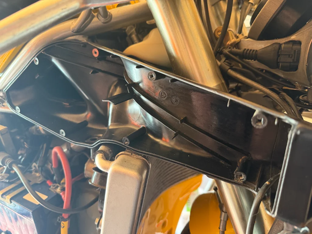

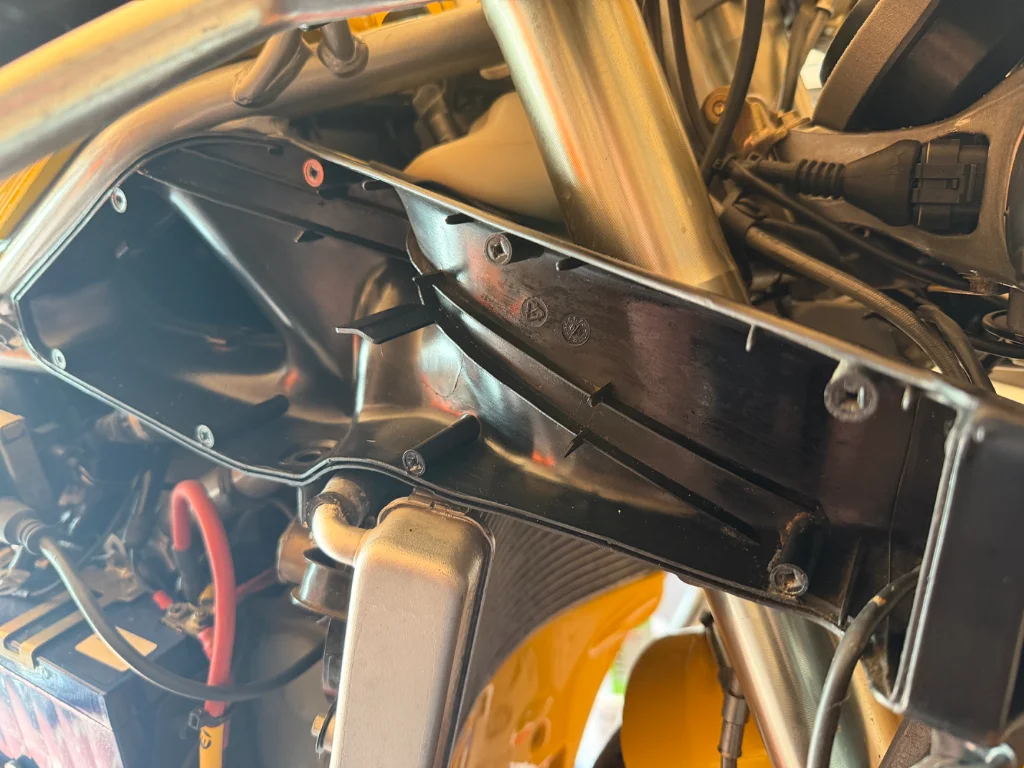

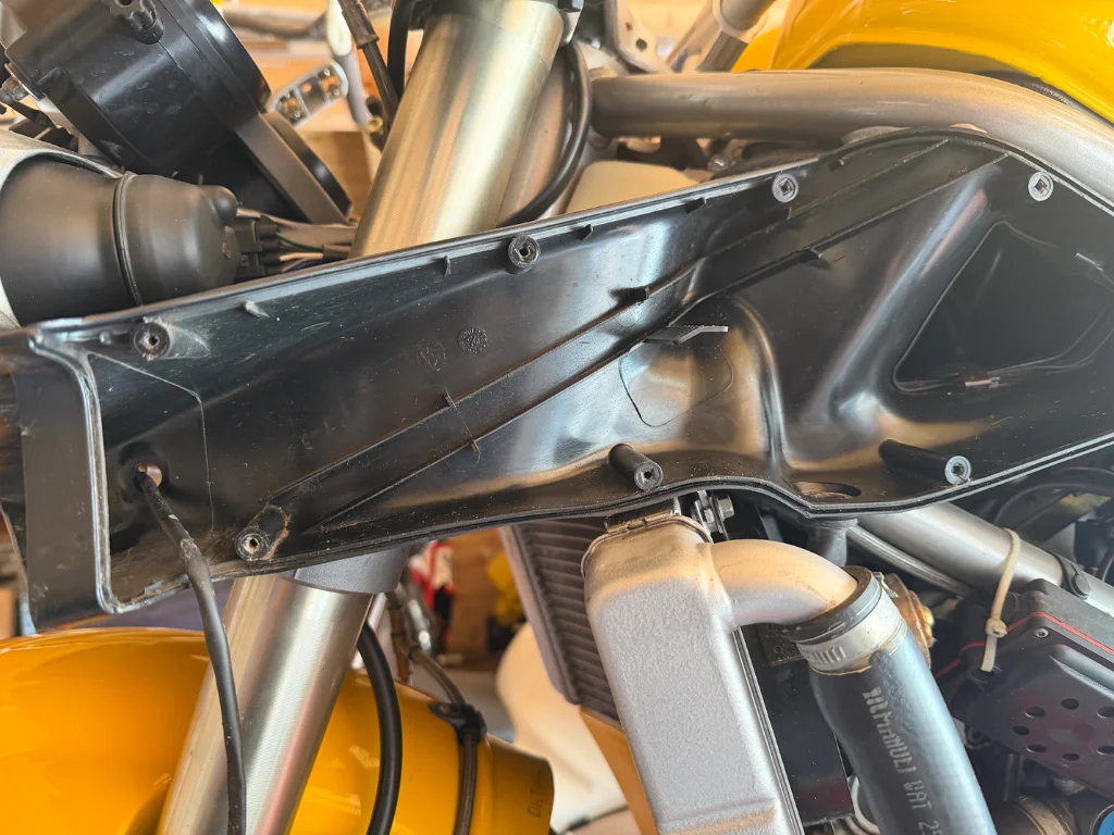

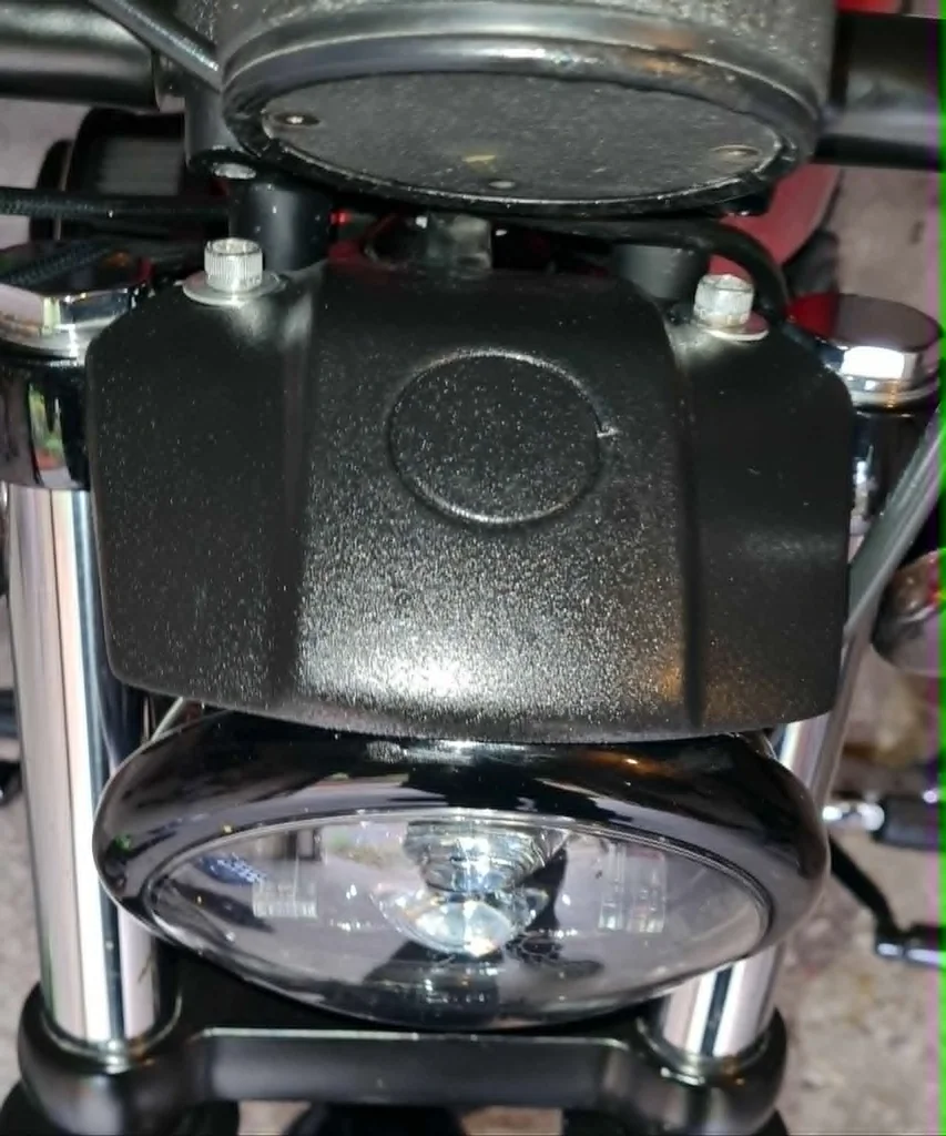

Today i was in the garage to fit the newly painted headlight bracket, well happy with it, next i'm going to mask the clock and spray the back of it. It's got realy cold again, the weather has gone mental, it's meant to be warming up a bit on Friday.🥳

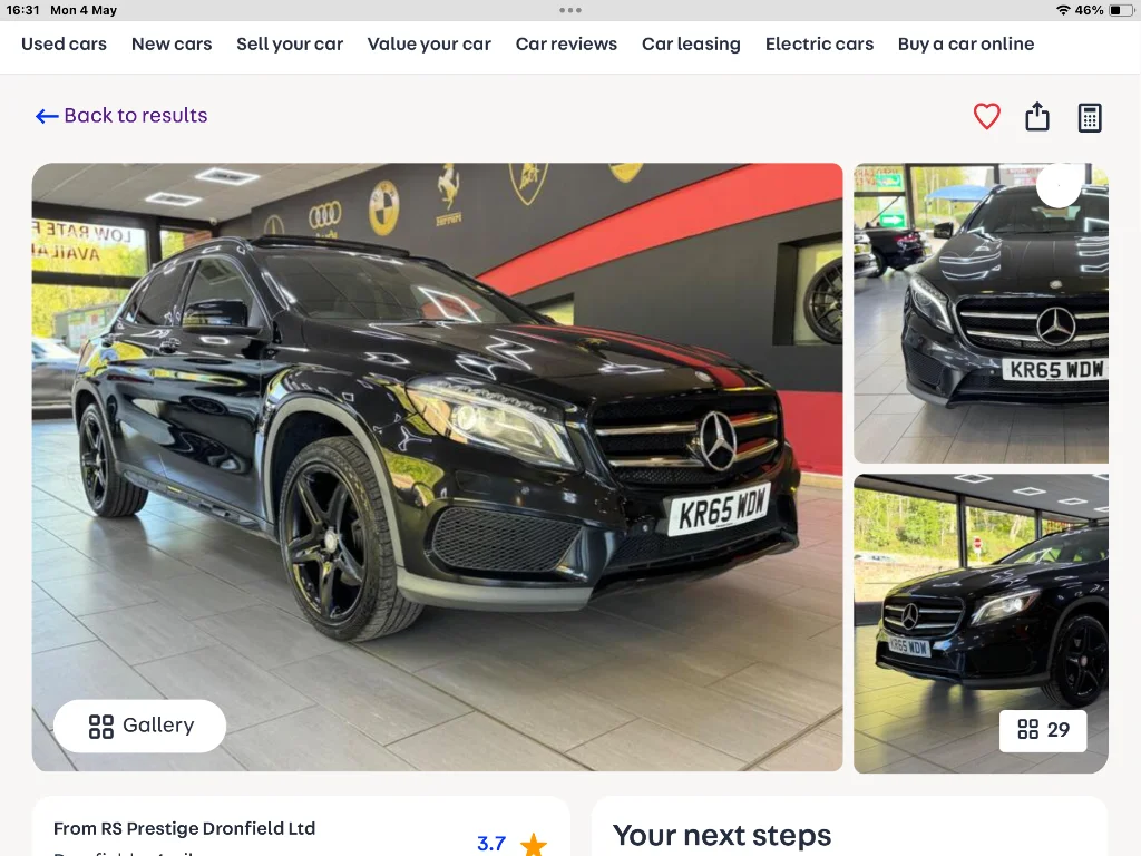

Sold my VW Transporter last week, so I’m looking for a car around the £10K mark, anyhoo, I’ve cogitated and searched and I quite fancy this.
Now, in the list of criteria, getting in and out of it and the comfort whilst I’m in it are quite high up, can anyone suggest an alternative?
This has come up too, but something is telling me it'd be a bad idea. Lot of car for the money though.

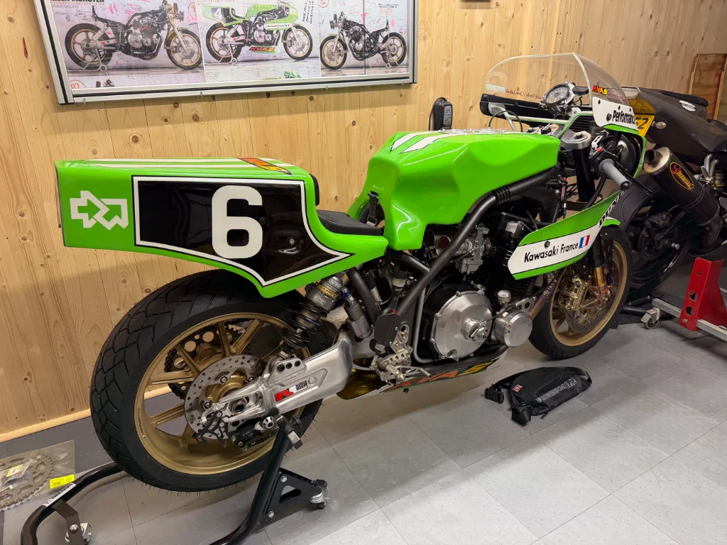

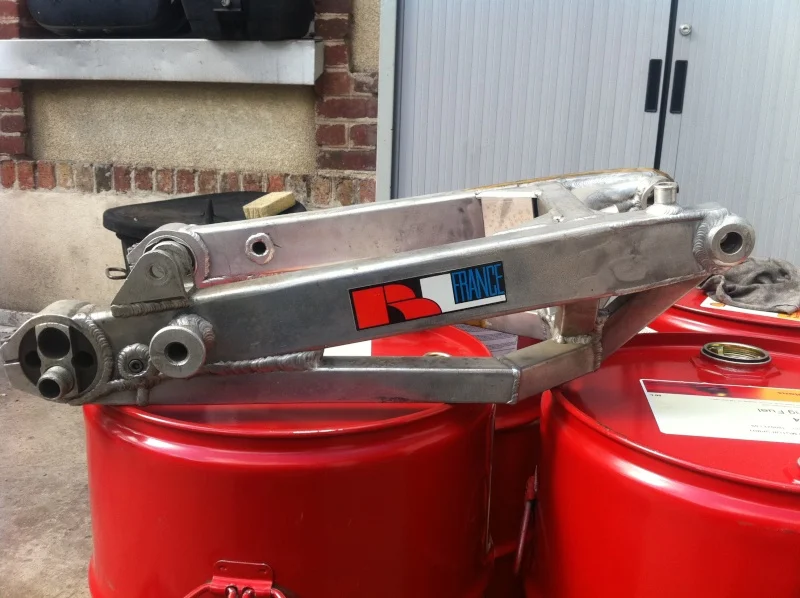

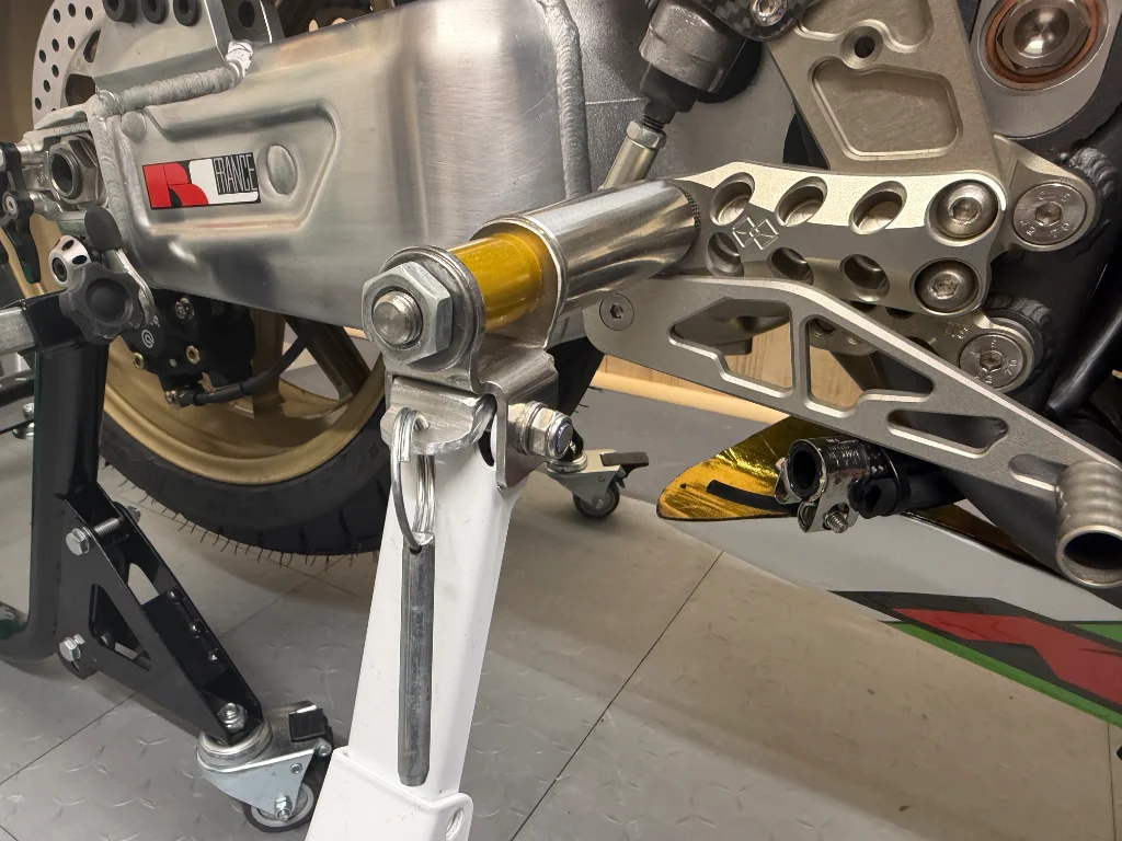

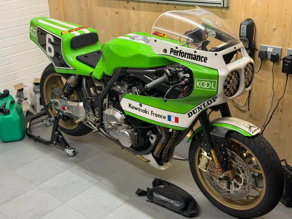

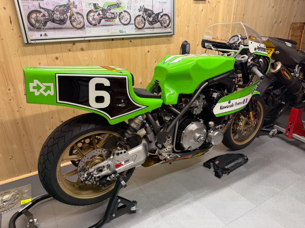

The swingarm in the poster looks like an early Metmachex, with the eccentric adjusters.
What is the origin of your swingarm?
If only there was a thread dedicated to your build.
Is it officially finished now?
This will be it's 3rd year on the road 🥳 silly billy 🤪
Mine is as Noobster says - a Ducati 999 swing arm.
The one on the original is either a Showa (who built the frame, or Kawasaki) but they only built 2 (+ spares for two bikes I guess)
